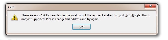

OS> Windows 7 Ultimate Email client> Thunderbird 38.6.0 Not supported, see the picture in attach. On 6.3.2016 17:29, Andre Schappo wrote:
