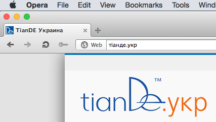

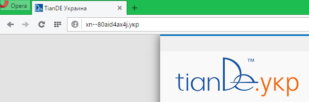

Dear all, Please, find screen-shot with illustration of the Opera's work on UA uri-string was defined as тіанде.укр (tiande) bad visualization in punycode only, resolving ok. -- Yuri mailto:yvk@uanic.info

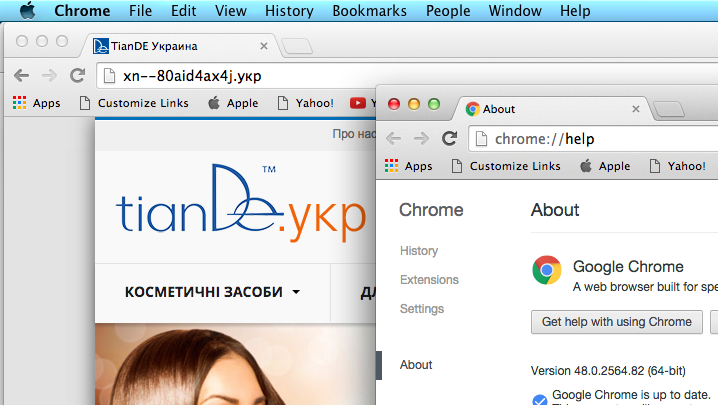

Dear Yuriy, thanks. This kind of error is similar in Google Chrome and Firefox, when the user's language support and script are set as different than IDN input in location bar. Cheers, Dusan On 20.1.2016 18:34, Yuriy Kargapolov wrote:

Dear Dusan, thanks Is it only one way - to write relevant letter in Opera's address? Does Opera was not aware and ignored as a child IDN questions? :) How many letters must be from us? :) We done. --Yuri Wednesday, January 20, 2016, 10:15:04 PM, you wrote:
Dear Yuriy, thanks.

Thanks Mark, Bing really correctly finds web-site тіанде.укр and launching the correct site, visualization the second level in punycode, TLD = .укр, i.e. visualization of the TLD is correct --Yuri Thursday, January 21, 2016, 9:25:33 PM, you wrote:

Dear Dusan, thanks

I have just tested Opera on OSX and it correctly shows the Unicode form тіанде.укр in the address bar. Please see attached screen shot André Schappo [cid:754A7B3F-1673-4E8B-A3DE-6140B85E371D] On 20 Jan 2016, at 17:34, Yuriy Kargapolov wrote: Dear all, Please, find screen-shot with illustration of the Opera's work on UA uri-string was defined as тіанде.укр (tiande) bad visualization in punycode only, resolving ok. -- Yuri mailto:yvk@uanic.info<Opera-UA-w-idn.jpg>

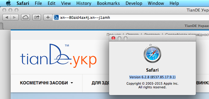

Hello All, 1.OSX Safari Version 6.2.8 (8537.85.17.9.1) changes string тіанде.укр to http://xn--80aid4ax4j.xn--j1amh right after you push enter after copy pasting the URL formally it works, but not very human readable 2.OSX Chrome Version 47.0.2526.111 (64-bit) changes тіанде.укр visually to http://xn--80aid4ax4j.укр , but if you copy the text via CTRL-C it turns to be in the clipboard -> http://xn--80aid4ax4j.xn--j1amh/ P.s: and OSX Opera allows you to copy paste http://тіанде.укр/ without alterations. Sincerely Yours, Maxim Alzoba Special projects manager, International Relations Department, FAITID m. +7 916 6761580 skype oldfrogger Current UTC offset: +3.00 (Moscow) On Jan 22, 2016, at 12:56 , Andre Schappo <A.Schappo@lboro.ac.uk> wrote:
On Jan 22, 2016, at 2:41 AM, Maxim Alzoba <m.alzoba@gmail.com> wrote:
1.OSX Safari Version 6.2.8 (8537.85.17.9.1) changes string тіанде.укр <http://xn--80aid4ax4j.xn--j1amh/> to http://xn--80aid4ax4j.xn--j1amh <http://xn--80aid4ax4j.xn--j1amh/> right after you push enter after copy pasting the URL
Maxim, It’s entirely likely older versions of Safari had this issue. The latest version of Safari is version 9.1 and it does NOT change the string тіанде.укр to punnycode after pasting the URL. -- Eric Zelenka Worldwide Product Marketing Apple Inc.
