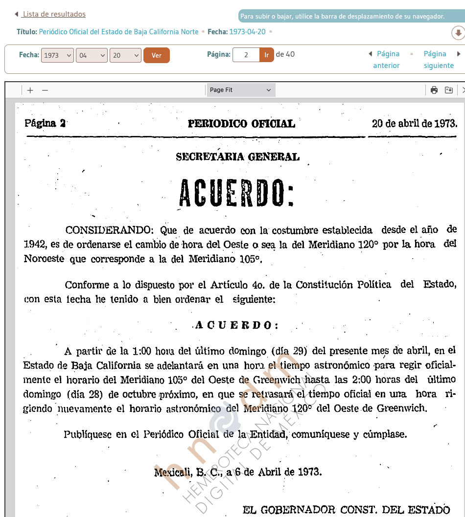

A user of our astrology service, born in 1973 in he border town Mexicali claimed that they observed DST in his town, just like on the other side of the border in California, when he was born on 30 May 1973. I did a quick newspaper archive research on https://hndm.iib.unam.mx/ and found that Título: Periódico Oficial del Estado de Baja California Norte Fecha: 1973-04-20 states clearly that DST was observed from last Sunday in April to last Sunday in October. This means the the TZ table above is false, at least for 1973. I assume that the same is the case for several other years. I attach the screenshot for 1973 The page https://hndm.iib.unam.mx/consulta/publicacion/visualizar/558075be7d1e63c9fea... should allow to search for other years as well. I used the keywords *hora legal* for my search, though do not see that now in the URL.
Título: Periódico Oficial del Estado de Baja California Norte Fecha: 1973-04-20 <>states clearly that DST was observed from last Sunday in April to last Sunday in October.
I used the keywords hora legal for my search, though do not see that now in the URL.

Thanks for that research on Baja California. I installed the attached proposed patches. The first one is for Baja California and goes back to what Shanks said about Tijuana, as this agrees with your data. The second one is commentary about Zapotec timekeeping which I found while looking into the matter.
