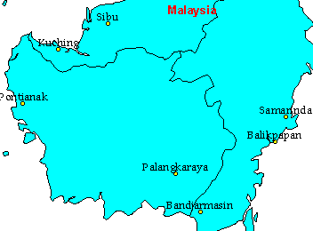

* Southwest Borneo switched from +08:00 to +07:00 on 1988-01-01. This entails a new zone 'Asia/Pontianak'. (Thanks to Gwillim Law for this.) Funny, I had it all along right under my nose without noticing it. I send a screenshot from my program World Time Explorer which shows the region. And the line down the middle of Borneo from Malaysia actually *is* a time zone border - I just hadn't realized it, since the line towards Malaysia is a country border, not a time zone border. Can anyone confirm that Palangkaray (with population 148,700 latitude -2.19 and longitude 113.82) is also on GMT+7 just like Pontianak, and that Bandjarmasin (with population 534,600 and latitude -3.34, longitude 114.57) is on GMT+8? The screenshot I send is BorneoSouthWest.gif. The map was developed by Manifold, check out http://www.manifold.net/download/freemaps.html.
If the time zone border had been there since 1970, we wouldn't have needed an entry for Pontianak in the tz database; we could have just asked people in Pontianak to use the Jakarta entry. The news here was that Indonesian west Borneo has switched since 1970. This news is not in Shanks (1995), nor is it in Gwillim Law's summaries of the IATA data (those summaries started after the switch).
Can anyone confirm that Palangkaray (with population 148,700 latitude -2.19 and longitude = 113.82) is also on GMT+7 just like Pontianak, and that Bandjarmasin (with population 534,600 and latitude -3.34, longitude 114.57) is on GMT+8?
Here is some confirmation: <http://www.sumatera-inc.com/go_to_invest/about_indonesia.asp#standtime> <http://www.airportcitycodes.com/aaa/ctydef/pcity.html> (look for Palangkaraya) <http://www.airportcitycodes.com/aaa/ctydef/pcity.html> (look for Balikpapan) Balikpapan is not the same as Bandjarmasin, but it's the closest airport that I could find. By the way, I just found out about airportcitycodes.com; my guess is that it is derived from the IATA data. It gives only standard times, but that is better than nothing. Perhaps I should add it to tz-link as well; I don't know of any other place that publishes the IATA data on the web.
