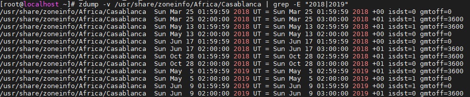

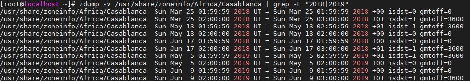

In the past, Morocco observed four clock changes per year. Like in most other countries with seasonal time changes, the DST period in Morocco started in the spring and ended in the fall (autumn). However, clocks were turned back to standard time during the Islamic month of Ramadan to make it easier to observe the daytime fast. The Kingdom of Morocco now remains permanently set to UTC+01:00 instead of following an earlier plan to return to UTC+00:00 on October 28, 2018. But the data in Africa doesn't change. There still are four clock changes in 2018, which causes isdst flag error in 2019. https://support.microsoft.com/en-us/help/4468323/dst-and-time-zone-changes-i... https://www.timeanddate.com/news/time/morocco-abolishes-time-changes.html Before change, [cid:image001.png@01D59979.EB9BDA90] on May 5 2019, the time jumps from 02:59:59 to 02:00:00, the isdst flag should change from 1 to 0. After change, [cid:image002.png@01D59979.EB9BDA90] When dataform is rearguard, it is fixed via ziguard.awk, [cid:image003.png@01D5997A.49F01BB0] However, I don't understand why it's only changed in rearguard format.
Yes, that's right. Standard time in Morocco is now +01.
But the data in Africa doesn’t change. There still are four clock changes in 2018
On 2018-10-28, Morocco switched its standard time from +00 to +01 without changing its clocks, instead of its previous practice of switching from DST (+01) to standard time (+00) in fall. So from the tzdb point of view, the only thing that happened on 2018-10-28 is that the tm_isdst flag changed from 1 to 0 at 03:00 local time.
That's not how the mainline tzdb models Ramadan in Morocco. tzdb says that standard time in Morocco is +01 (as noted above), and that daylight saving time is +00 during Ramadan. In other words, daylight saving time has a smaller UTC offset than standard time, a situation that is unusual but is allowed by POSIX and by tzdb. Ireland is similar.
However, I don’t understand why it’s only changed in rearguard format.
Some downstream users don't yet handle this situation, and the rearguard format allows them to get their work done in the meantime. But really, if you're doing work in this area you should support so-called "negative DST", as it is used occasionally and POSIX requires support for it.
